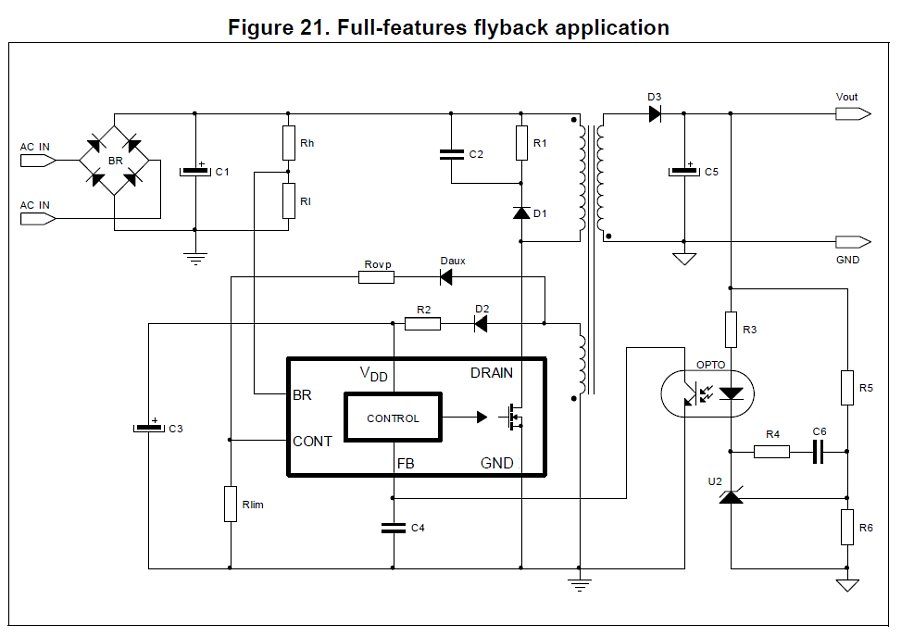

Energy saving VIPerPlus: HV switching regulator for flyback converter
Схема включения VIPER17; VIPER17L
Features
  • 800 V avalanche rugged power section
  • PWM operation with frequency jittering for low EMI
  • Operating frequency: – 60 kHz for L type; – 115 kHz for H type
  • Standby power
  • Limiting current with adjustable set point
  • Adjustable and accurate overvoltage protection
  • On-board soft-start
  • Safe auto-restart after a fault condition
  • Hysteresis thermal shutdown
Applications
  • Adapters for PDA, camcorders, shavers, cellular phones, videogames
  • Auxiliary power supply for LCD/PDP TV, monitors, audio systems, computer, industrial systems, LED driver, No el-cap LED driver SMPS for set-top boxes, DVD players and recorders, white goods
