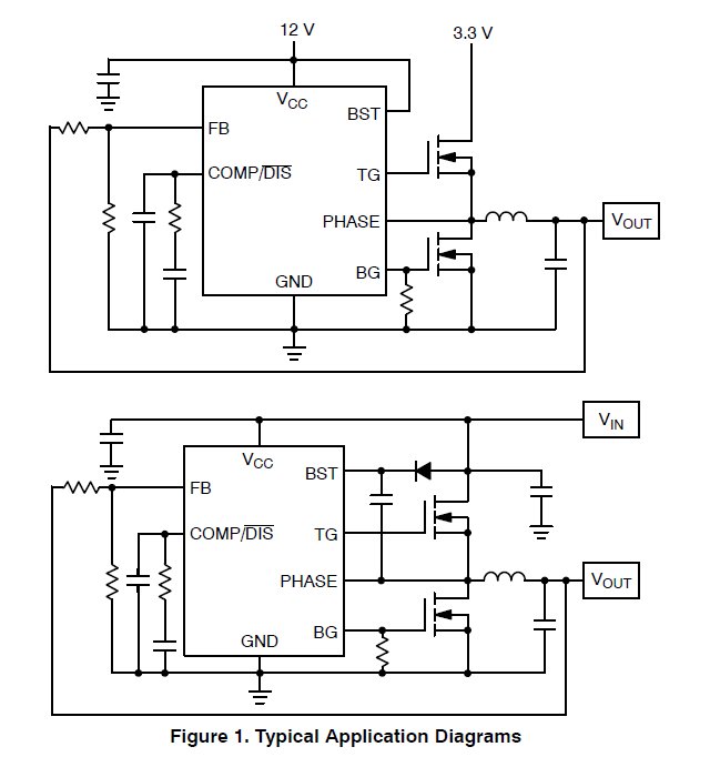

DataSheet NCP1579
Low Voltage Synchronous Buck ControllerFeatures
- Input Voltage Range from 4.5 to 13.2 V
- 275 kHz Internal Oscillator
- Boost Pin Operates to 30 V
- Voltage Mode PWM Control
- 0.8 V ±2.0 % Internal Reference Voltage
- Adjustable Output Voltage
- Capacitor Programmable Soft?Start
- Internal 1 A Gate Drivers
- 80% Max Duty Cycle
- Input Under Voltage Lockout
- Programmable Current Limit
- These Devices are Pb?Free, Halogen Free/BFR Free and are RoHS Compliant
Applications
- STB
- Blue-Ray DVD
- LCD_TV
- DSP & FPGA Power Supply
- DC-DC Regulator Modules
