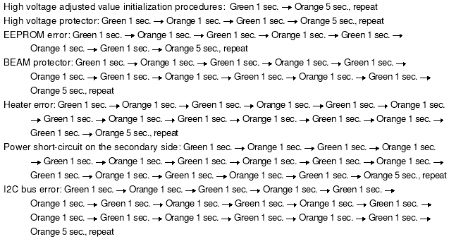

Mitsubishi DPro 930SB:
everest

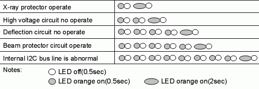

Nec FE750+ Error Codes:
1. High Voltage Error:
short0,5s flash 3s Long 2s flash 1s
2. Deflection Circuit Stop:
short0,5s flash 4s Long 2s flash 1s
3. Beam Protector:
short0,5s flash 5s Long 2s flash 1s
4. Heater Power Error:
short0,5s flash 6s Long 2s flash 1s

16-11-2006 12:25
NEC FE1250+ & FE950+
