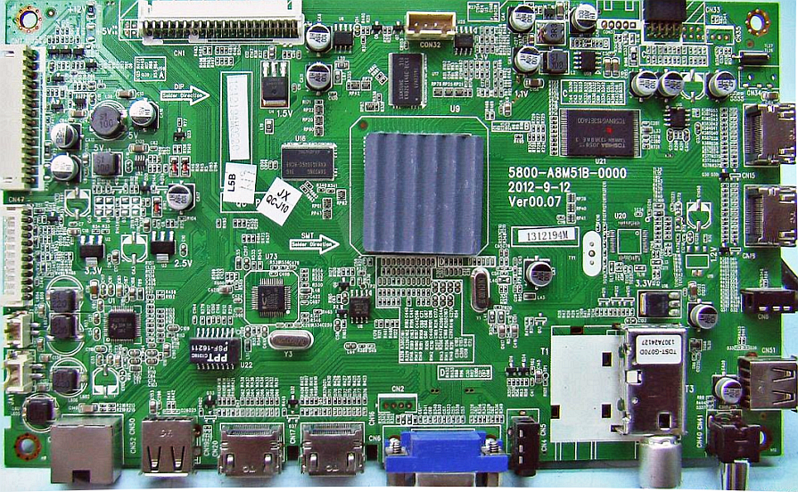

Прошивка ЖК телевизора AIWA 47LE71113
- Chassis: V1N03 chassis 8M51B
- LCD Panel: LC470EUJ-SFK2 (SEL470FY)
- LED driver (backlight): 168P-P47DWM-W2 5800-P47DWM-W200 VER00.00
- Power Supply (PSU): 168P-P47ELL-W1 5800-P47ELL-W000
- Main Board: 5800-A8M51B-0000 Ver00.07
- CPU: MSD6329SV
- Eeprom: K24C04
- SPI Flash: 25L1606E (MX25L1605A)
- NAND Flash: TC58NVG1S3ETA00
